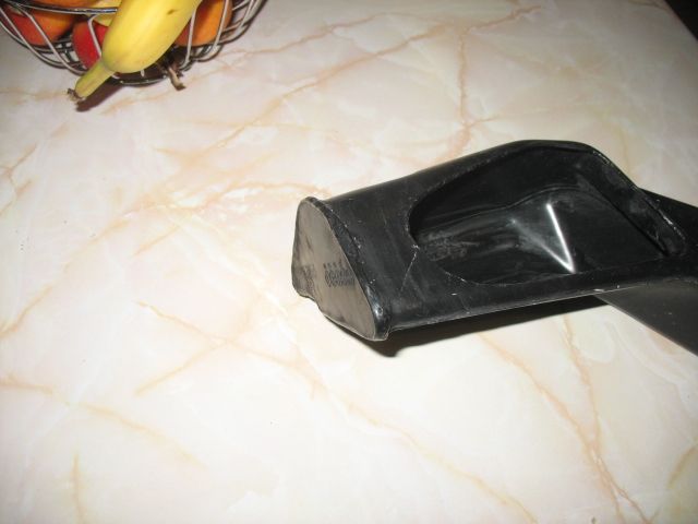

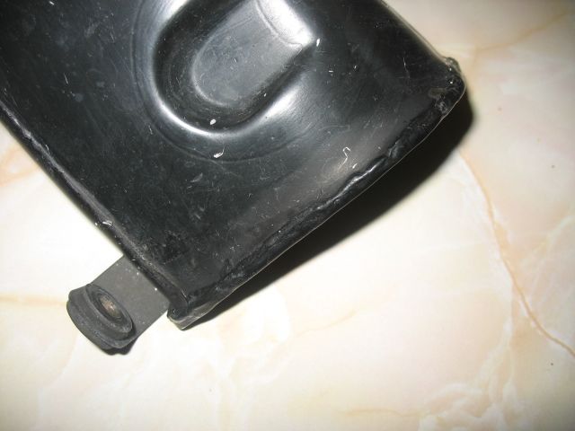

Looking at the stock air intake i realized theres a chance to get the air injected instead of being sucked in to speed up the air travel speed.
Small change:
Blanked the side entrance:
First time im my life ive done plastic welding and it came up quite well:
