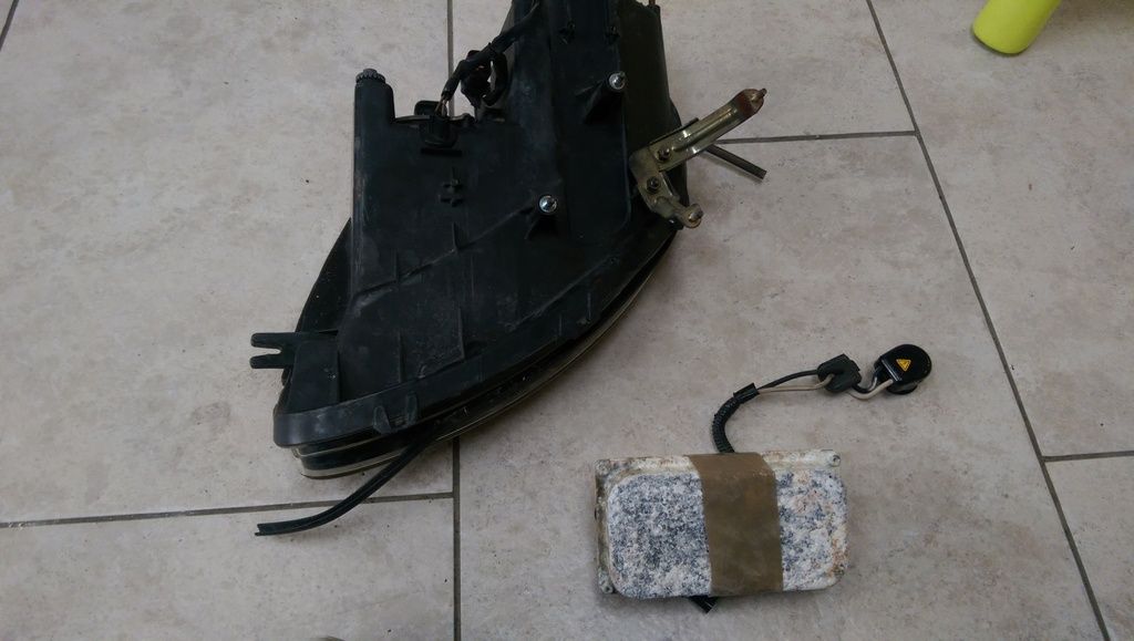

Hid ballast was gone, so bumper off and took it out. Replaced with one from temeeo's crashed fto.
Both working now and p/s spot refitted
